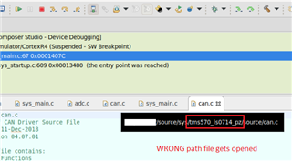

If I have 2 folders with identically named sources, and in my CCS project settings I have multiple Build configurations which enable, disable specific target sub-folders, it seems the CCS debugger Source loop up does not care for this, and includes all available sub-folders (in my case multiple targets socs).
The built sources are correct , as checked.
At runtime, this gets confusing as debug /break points trigger opening wrong source files while stepping through the code, as the CCS /debugger navigation can be opening wrong file, from another sub-folder / not used.
E.g;
So in the above, while I debug on 1227, it wrongly opens for me files from 0714 target, even though that's disabled.
Of course, I should be able to change the debug configuration and prob remove the default / auto inserted Source Look Up path and re-insert all manually, but this is very cumber some if I have many configurations.
Don't see anything better besides removing entirely the excluded folders, which I also don't want to do (Removing entirely means they disappear from all configurations).

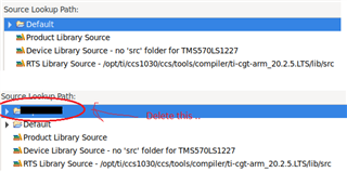

    However, debugger ,  just looks in __ALL__ sources , and , if seems / appears to me, that say, if it finds source file "can.c"  in the first sub-folder which just happens to be alphabetically first, then it will use that "can.c" as the file currently debugged - which will be WRONG because it is not the one that was built.  So this source look up doesn't work properly  if you use CCS defaults where it  looks into sources _relative_ to  project as I understand it : there is a project folder right at the top at the Source Lookup Path.
    Actually deleting that "project" folder  from the source look up, and leaving only "Default" , seems remedies this issue with my ccs debug configuration - BUT I have to do this everytime debug configuration gets created.

    .. And , in both cases this would have correct full path to the can.c file .  BUT,  only with the following change in Source look up - i'm deleting project's top path as highlighted
    .. only then it resolves to correct path - the 1227 variant, and not to other, as below : ( shows wrong file gets popped open):
    Hope my snapshots explain what I meant.
