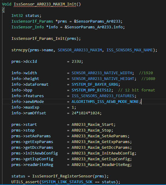

We are integrating AR0233 sensor in VisionSDK using TDA2P. We are using Maxim SERDES along with the sensor.
Specifications of Input sensor are as follows:
  1. Resolution : 1920 * 1080 at 60 fps
  2. Data format : RGB Bayer RAW 12 bit
  3. MIPI 4 lanes
Settings done in init() function of sensor.c file are as follows :
The interface information for the sensor is as follows :
Input image received with this settings is as follows : We dumped the RAW image from usecase and tried to visualise it :
Can you tell us if any modifications are need in the settings, to receive correct data from sensor?
We would like to know if csi2PhyClk parameter setting done in interface_info structure is corrrect and how this value results in certain frequency for CSI interface.
