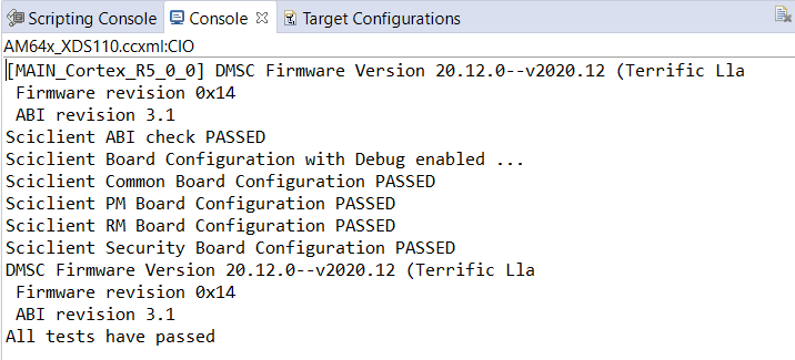

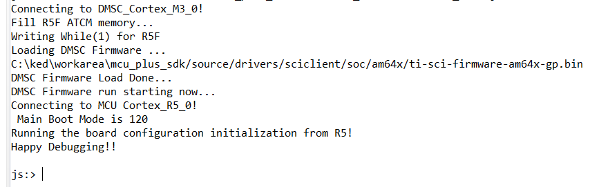

    Could you please try these steps and let us know your results?
    1. Set EVM to NO BOOT mode:
    2. Power on the EVM
    3. In CCS, launch the target configuration for the AM64x_EVM
    4. Once launched, open the CCS scripting console (View -> Scripting Console)
    5. Run the DMSC init script in the scripting console:
    You should see the following output. Could you please confirm you see the same?
    At this point you should be able to connect to the CORTEX_R5's and run the DDR initialization script.
    For #2, could you please share the full log that you see when compiling?
    Sahin
  • I am facing the same error signature.
    I tried running the js and received this error:
    js:> loadJSFile <scrubbed>/ti/mcu_plus_sdk_am64x_07_03_00_19/tools/ccs_load/am64x/load_dmsc.js
    Connecting to DMSC_Cortex_M3_0!
    Error connecting to the target: emulation failure occurred (<scrubbed>/ti/mcu_plus_sdk_am64x_07_03_00_19/tools/ccs_load/am64x/load_dmsc.js#146)

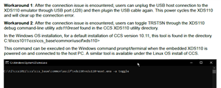

  • Hi Sahin,
    Thank you for your reply.
    According to your documents, but there is error.
    (Error -1170 @ 0x0)
    Unable to access the DAP. Reset the device, and retry the operation. If error persists, confirm configuration, power-cycle the board, and/or try more reliable JTAG settings (e.g. lower TCLK).
    (Emulation package 9.3.0.00058)

  • Hi Richard and Zhonghui,
    This is apparently a known issue with the E2 revisions of the EVM, see section 4.1 of the EVM User Guide:
    Sorry for the delay in finding this. Please let me know if these suggested workarounds for you.
    Sahin

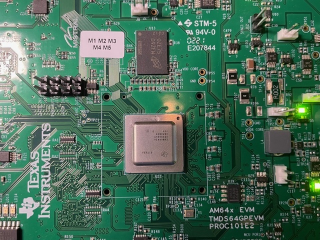

    Could you please share which EVM revision you have? The label can be found here:
    Sahin
  • Also when you go to dev.ti.com, does your EVM get detected? (Make sure your board is connected, powered on, and no CCS target configuration is running)
    Sahin
  • Hello Sahin,
    The photo having the requested information is here.
  • Hello Sahin,
