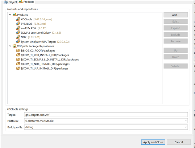

TMDSIDK437X: UIA not work
Part Number: TMDSIDK437X
Other Parts Discussed in Thread: CCSTUDIO
Hello.
I can't start UIA tools.
I I made the settings as recommended in the documentation sptuh43f. But for some reason the configuration file UIA is not created. What could be the reason? I used the tool UIA in another project, there were no problems.
When target loaded and JTAG is paused.
Regards, Dmitry.
  • Hi Dmitry,
    Let me check about this internally and get back to you.
    By the way, are you using your own application? OR having issues on one of the CCS projects that is released out of Processor SDK?
  • Hi Dmitry,
       Could you please attach your .cfg script?  Also, please provide a list of the files in your Debug folder after you've built your project.  Also, what version of CCStudio, UIA and XDC are you using?
    Brian
  • Hi, Brian.
    7633.app.cfg
    Regards, Dmitry.
  • Thanks Dimitri.
    Could you also list the contents of the Debug\configPkg\package\cfg folder?  there should be some xml files that end in .uia.xml, .cfg.xml and possibly .rta.xml
    Also, could you check that the ...REV1.map file contains entries for stairstep_JTAGStopMode and that it is properly allocated in memory?
    I'm trying to pull together a project with the same component versions as you are using to see if I can replicate the problem you are encountering.  I'll post here when I have any further info on that.
    Brian

  • Thanks Dmitry
    It looks like System Analyzer is not able to locate the .uia.xml and .rta.xml files for some reason.  A workaround is to copy the files to the same folder that the .out file is in, and to ensure that the filename matches the name of the .out file exactly.  Sometimes the use of unusual ASCII characters can cause problems with detecting the files as well.   Could you try doing that and see if the problem is resolved.
  • Hi, Brian.
    I have followed your recommendations. Unfortunately this did not solve the problem.
    I also tried to build a new project from examples, everything works there.
    Regards, Dmitry.
  • OK, thanks Dmitri
    Could you try to evolve the working example project so that it is running the same C code as your other project, and merge in the differences between the .cfg file of your project into the .cfg file of the example project (e.g. using a tool like Beyond Compare from Scooter Software)?  Sometimes starting with something that works and evolving it is the easiest way to figure out what the problem is, or at least end up with a solution that works.  It seems to me that there is something about the way your initial project evolved that caused some linkage to break...  Try to avoid changing e.g. the name of the project as that can cause problems.  I noticed that in your debug folder you have 2 .map files with different names, which indicates you might have changed your project name at some point, and that might have been where things stopped working.   Try doing the migration incrementally and testing at each step to see if UIA is still working or not, so you can identify at which point the problem comes into being.
    Brian
  • Hi, Brian.
    Do you have any other options? I would not really like to start over. I don’t know the tool you suggested, I’ve heard about it for the first time.
    Unfortunately, I still have anothe problems with the project, I'm trying to solve them in another branch.
    e2e.ti.com/.../am4379-cortexa9-trouble-writing-memory-block-at-0x0-on-page-0-of-length-0x7ff0-error--1065-0x3d5a
    But I'm afraid that I won't be able to do it. The matter comes to a standstill. My knowledge and experience is not enough.
    Regards, Dmitry.
  • It seems to me that there is something about the way your initial project evolved that caused some linkage to break...  Try to avoid changing e.g. the name of the project as that can cause problems.  I noticed that in your debug folder you have 2 .map files with different names, which indicates you might have changed your project name at some point,
    Hi Dmitry,
    Any inputs on above? By the way what Brian C suggested is to compare working example project and failing one using compare tools such as Beyond Compare or Meld or anything you prefer/use.
