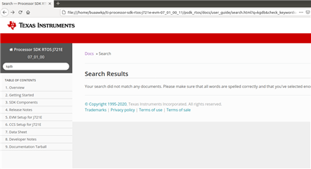

  • Hi Keerthy J,
           Where is the manual to use kgdb debugging, I can't found it in useguide.
    Jason
  • Hi Jason,
    That is correct we do not have KGDB on our SDK. So something you will have to debug & test on your side.
    Enabling it should not have any dependency on the hardware. So you could probably reach out to linux mailing lists.
    Keerthy
