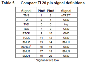

I'm sure my XDS560 Debug Probe is working as I've tested it on my J721e_evm board. The following is my schematic in which the TPs connect to TI_20 pins.
Please let me know what I can do to resolve the issue.
