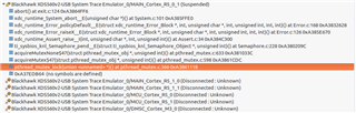

  • 1. TDAVM
    2. SDK QNX 7.1.
    3. Add some algorithm code to MCU2_1.
    4. Use vision_apps demo can run successfully, BUT after add our code, it can't run.
    Log shown crash in main thread.
    Jtag information as follow:

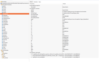

  • Hi expert,
    Detail log information from CCS as follow:
    ROV error log as follow:
    HWI:
    Caught exception in view init code: "/media/liufu/8CEA9AF9EA9ADF30/code/ti-processor-sdk-rtos-j721e-evm-07_01_00_11/bios_6_83_00_18/packages/ti/sysbios/family/arm/v7r/keystone3/Hwi.xs", line 554: Cannot read property "ENABLEDSET" from undefined
    Queue:
    Error: Problem scanning pend Queue: JavaException: java.lang.Exception: Target memory read failed at address: 0xffffffff, length: 8This read is at an INVALID address according to the application's section map. The application is likely either uninitialized or corrupt.
