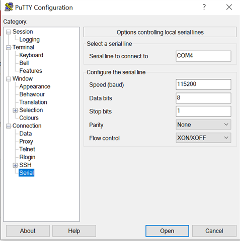

  • Hi Nancy,
    I have a couple follow up questions: 1) how did you determine which com port, of those the evm provided, to connect to on your PC?, 2) could you post a screenshot of your full serial settings in putty (the last tab on the bottom left of the putty interface)?
    Andrew
    I checked device manager-> ports
  • The BOOTME and runtime application are not using the same clocks. The BOOTME is printed by the device boot ROM, with the PLL clocks in bypass mode The UART logs that you are printing from the application are using UART driver and will setup the UART clocks based on PLL0_SYSCLK2 values configured.
    Are you seeing this issue with TI LCDK platform? What is the GEL file you are running? Can you first run the UART examples before testing NIMU examples. The BOOTME definitely helps sanity test that the UART HW pins are connected correctly. The garbled messages are most likely due to clocking issues so we need to understand that the value set in your GEL file for SYSCLK2, matches with the UART module clock used in UART_soc.c file

    Yes, i tested on TI LCDK platform, and i have test UART_BasicExample_lcdkOMAPL138_armExampleProject as well, it's also garbled.
    I used GEL: ccsv8\ccs_base\emulation\boards\lcdkomapl138\gel
    ARM9_0: Output: PLL0 init done for Core:300MHz, EMIFA:25MHz
    ARM9_0: Output: DDR initialization is in progress....
    ARM9_0: Output: PLL1 init done for DDR:150MHz
    ARM9_0: Output: Using DDR2 settings
    ARM9_0: Output: DDR2 init for 150 MHz is done
    So PLL0_SYSCLK2 = 150MHz
    Where is UART module clock defined in UART_soc.c?
  • The UART module clock in UART_soc.c found in the folder pdk_omapl138_1_0_10\packages\ti\drv\uart\soc\omapl138 and it is set to 150 MHz.
    I am not sure if this is related to a HW issue that the output appears to be garbled. The base UART Example is system tested so we don`t expect the base example to have any issues.
