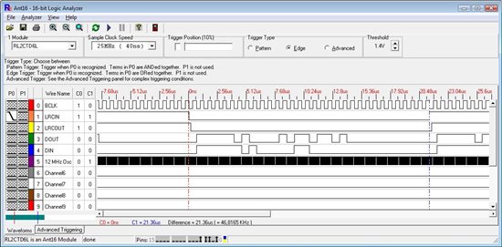

After I adjust some registers in McASP init the SW works and I put audio signal into codec input through ADC - DAC and out to speakers. But the signals has little noise.
Then I checked the clocks and found out that the Clock ACLKX1 is too slow (should be 12 MHz to feed into BCLK of codec) - only 1.66 MHz:

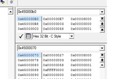

I checked the registers of the clock stage and the HCLKXDIV is set to 1 so I measured 12 MHz at output pin AHCLKX pin with
logic probe. I init the divider CLKXDIV to 1, but the ACLKX pin is 1.66 MHz and the memory registers show following:
The register is set to 0xE7 but I init with 0xE0. The devider value of 0x07 is correct for the 1.66 MHz. In memory window I changed the value to 0xE0 hard and measured the
clock ACLKX: Result: 12 MHz. In software I set all CLKXDIV bits to "0" - never changes. Then (for test) I set one of the higher register bits to "1" to check that the right register
is used: the register is OK.

What is wrong there? Can anybody help me? With software init I can never change the divider bits of CLKXDIV. Always the value of 7h.
