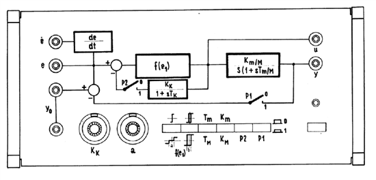

  • thanks for help guys. I will stay in touch because have to program OMAP-L138 in order to get my degree. My job is to make a laboratory station to examine influence of relays to control object. There is a front panel of  this station. I'm gonna need your help because the last microcontrolers i've worked with were PIC18F452, ATmega16, P89C51RC2 and to change it with OMAP-L138 is a big step.

    About my job though, do you think I can do this without ARM processor? Without specifics - user shoud be able to change algo processing real-time signals by interface I put in my erlier post. Is it possible to manage interrupts from status change of buttons on front panel or by pooling this parameters just by DSP? If not ( or even if yes) then how could I do this using ARM? ( Almost all materials I found to program OMAP L138 regard DSP. About ARM i found information how to run Linux, but I think in my case this is not best solution, do you?)
  • You could probably use either to accomplish this task.
    The DSP side of the part is excellent for real time processing. You can using this with TI's Real Time Operating System (DSP/BIOS) to implement your real time constraints.
    If you find that the DSP isn't sufficient enough, you could then use the ARM to offload a lot of the remedial tasks to free up more cycles in the DSP. I would recommend to start with only using the ARM or the DSP, but not both unless you find you need to. This simplifies the complexity of the programming by a significant amount.
