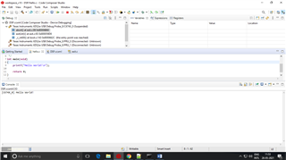

    Myself mohan, working with prashanth on OMAPL138
    when we run the code hello word on OMAPL138LCDKEVM (OMApL138 is unsecured component) we are getting the out from DSP  which is attached here.
    Now we are planning to load DSP.out file from OMAPL138LCDKEVM(OMApL138 is unsecured component) to our custom board which is having OMApL138 secured component.
    Kindly provide us the detailed procedure with commands to Flash the DSP.out file through UART on to the secure IC of OMAP L138
