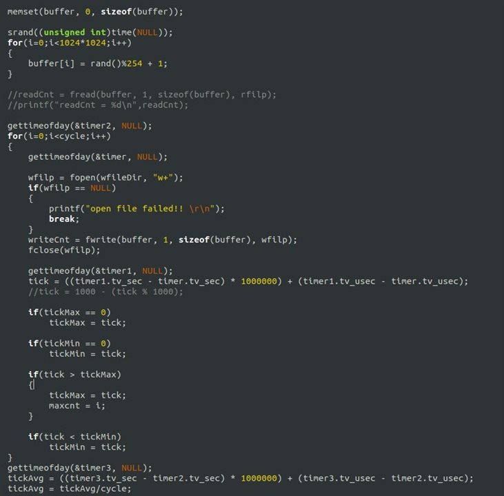

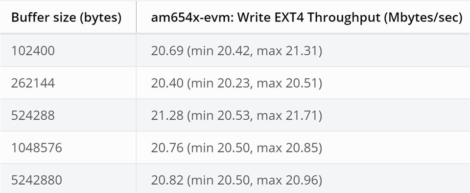

Hi Ti,
From below link, https://software-dl.ti.com/processor-sdk-linux/esd/docs/06_03_00_106/linux/Release_Specific_Performance_Guide.html#rt-kernel-performance-guide,

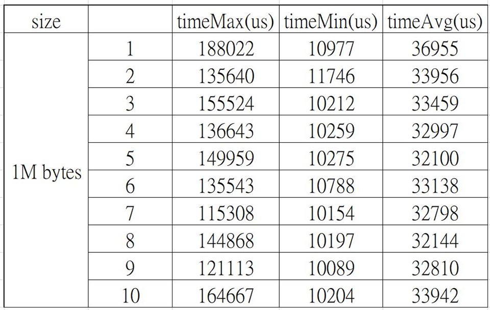

we can get the information about the emmc performance.
And we are trying to test writing 1MB file and get the performance on Linux RT SDK 07_01_00_18
As you can see below, the Max time and Min time have a big gap.
But in your result, it looks more stable.  If there is any setting need to configure?
Below is the sample code we use to test write 1MB file.
Thanks.

  • Eric,
    Can you share the code as a text file? The above is any image.
    Keerthy
  • Hi ,
    Attached the file.
    Eric

  • Hi
    I just looked into the result you provide and few questions want to check with you.
    1.What's the procedure of the test? something like "dd" or using fopen, fwrite as my test program?
    2.What's your cpu frequency? 800MHz, 1GHz or 1.1GHz?
    3.There are some test loops, all of them are with file size 100MB and srcfile 10MB, the difference is only buffer size. Correct?
    So, the test is to write srcfile(10MB) into file size(100MB)?
    |TRACE LOG|The application buffer size in bytes|102400|
    |TRACE LOG|file size in MB|100.00|
    |TRACE LOG|Iomode|write|
    |TRACE LOG|srcfile size in MB|10.00|
    4.I found almost the speed is about 38~42MB/s, but I still can see 18.35, 24.79 or 30.x MB/s. It looks like unstable. Isn't it?
    Eric
  • 2.What's your cpu frequency? 800MHz, 1GHz or 1.1GHz?
    800 MHz. This is the default frequency at which latest SDK boots.
    Yes. That is correct.
    I checked with MMC expert and yes there are outliers like 18.35, 24.7 etc. That is expected. So we take 38-42MB as the average.
    Definitely using dd. The test suite is pretty comprehensive. You can view the code: /opt/ltp/testcases/bin/ddt/blk/blk_device_filesystem_perf_test.sh
    Keerthy

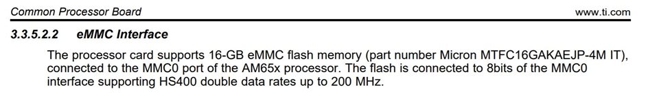

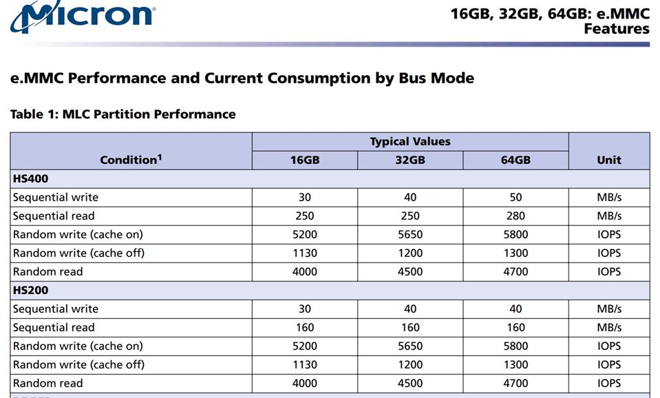

  • Hi Keerthy,
    I looked into the pdf file and found the emmc on EVM can support up to HS400 mode.
    And in k3-am65-mail.dtsi, the default setting for emmc is "mmc-hs200-1_8". It looks like am654 evm can only support HS200.
    After I look into the emmc spec, the speed can up to 30MB/s at HS200 mode,
    But according to your avg test result, it can up to 38-42MB/s.
    Could you confirm about this? Thanks.
    Eric
  • Hi Eric,
    Those were the numbers from our standard test suite. I am not sure if they are
    the conservative numbers from Micron but even our development team got
    the same numbers. I confirm. If no other questions please click on verify answer.
