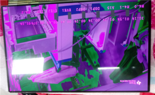

Difficult to say what is the problem, as I don’t know what is expected output. Can you first save input image to the DSS and compare it against DSS output?
It seems LCD is able to recognize input image, so timing is correct, but seems issue with the colors.
Are you seeing some color swap issues? If required, we can swap R and B colors in DSS.

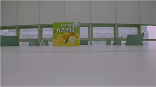

This is the output of yuv image coming from ISP:
This is the corresponding image seen on HDMI display:
Can you give more information about swapping R and B colors in DSS that you mentioned earlier.

It is difficult to correlate, can you share all three images, is isp output, hdmi output, and lcd output?
R and B can be swapped using CSC module, but before that we need to first understand if the issue is really R and B getting swapped.

Thank you for your suggestions. It seems there was issue with hardware on client side . So the issue is resolved.
