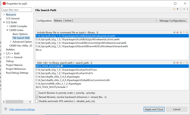

The function intcVectorTable is defined within the file C:\ti_hpc\pdk_k2g_1_0_16\packages\ti\csl\arch\c67x\interrupt.c that I have included in the library search path (see figure below)
Is there a missing library that I should include in order to fix the compilation failure?

  • Hi Benito,
    K2G has a C66x DSP, but you added intvecs.asm from the C67x CSL folder: C:\ti_hpc\pdk_k2g_1_0_16\packages\ti\csl\arch\c67x\src\intvecs.asm.
    Try to use C:\ti\pdk_k2g_1_0_16\packages\ti\csl\arch\c66x\src\intvecs.asm instead.

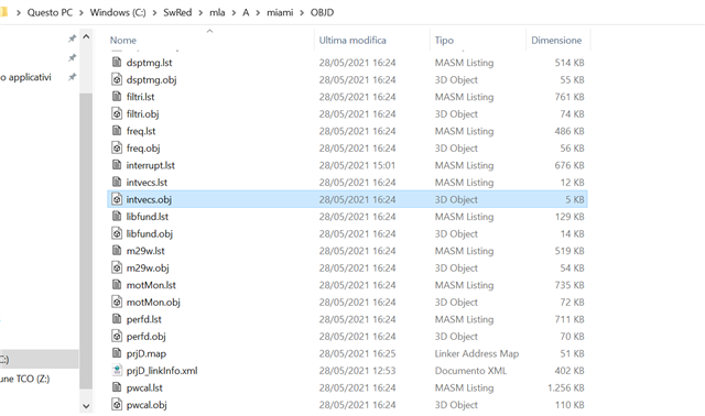

    I suspect that CCS10.2 does not compile the file intvecs.asm. This could explain the reason for which the symbol _intcVectorTable is not defined despite I correctly added the file intvecs.asm in my project.
    Should I change other settings in CCS10.2 in order to properly compile the vector table?

    Please, note that I correctly generate the obj files.
