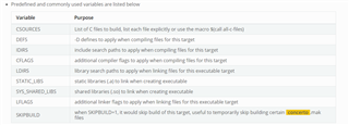

    1) What is the difference between CSOURCES := and CSOURCES += in the concerto?
    2) What is the difference between $(call all-c-files) and $(call allcfiles) in the concerto?
    Padmasree N.

  • Hi Padmasree,
    The aforementioned link defines the CSOURCES variable as below:
    If the question is on ":=" vs "+=", this is a 'make' convention, some online links below on this
    Setting Variables"-  :="  will overwrite the content of CSOURCES with the value specified.
    Appending to Variables - "+=" will append to the content of CSOURCES with the value specified.
    I am unable to find "$(call allcfiles)"  in the 7.3 SDK documentation or in source please provide a direct reference so I can respond.
    The macro "$(call all-c-files) "
      call - is a GNU function Call Function (GNU make)
    The macro itself is explained in the README file of the concerto directory, for example reference .../vision_apps/concerto/README.
    # list of c files c that exist inside this module (including any sub-directories)
    $(all-c-files)
    # list of c files c that exist in dir (including any sub-directories). dir is relative to the module directory
    $(call all-c-files-in,<dir>)
    The definition of the "all-c-files" can be found in concerto/definitions.mak
    As per the online documentation, the macro can optionally be replaced with a hardcoded list of .c files if that is desired.
    The intent is to populate CSOURCES with a list of C files.
    kb
