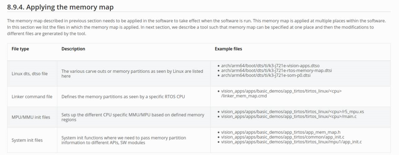

Dear expert.
May I ask if we have similar python tool for DRA821 to generate memory map files like TDA4VM?
In TDA4VM/DRA829 SDK, we have PyTI_PSDK_RTOS tool to do this.
Customer wants to change the memory map, this would great help to them to do that. thank you so much!
Thanks!
yong
  • Hi Yong,
    The tool is vision apps specific on DRA829.
    On DRA829, if we want to change the memory map for vision_apps firmwares we need to make sure the the corresponding changes to the Linux Device Tree are made. This is keep the memory used by vision_apps firmwares untouched from Linux.
    For DRA821 there is no vision_apps and hence no such tool.
    Can you please help me understand what kind of memory map changes is your customer trying to do?
