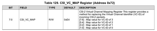

Do you know how to config the CSI_VC_MAP Register (Address 0x72)?

{0x6d, 0x78, 0x1}, /* PORT_CONFIG set to 00: CSI-2 Mode (DS90UB953A-Q1) **** */
{0xD5, 0xF3, 0x1}, /* Set AEQ MIN/MAX widest values*/ //????
/*The FV is equivalent to a Vertical Sync (VSYNC) while the LineValid is equivalent to a Horizontal Sync (HSYNC) input to the DS90UB913A-Q1 / DS90UB933-Q1 device */
{0x7c, 0x20, 0x1}, /* Normal Raw10 */
{0x72, 0x00, 0x1}, /* VC MAP to 0 */

{0x4C, 0x12, 0x1},
{0x32, 0x01, 0x1}, /** Enable TX port 0 */
{0x33, 0x02, 0x1}, /** Enable Continuous clock mode and CSI output */
{0x20, 0x20, 0x1},
{0xBC, 0x00, 0x1},
{0x5D, 0x30, 0x1}, /** Serializer I2C Address */
{0x65, 0xEA, 0x1},
{0x5E, 0x20, 0x1}, /** Sensor I2C Address */
{0x66, 0x34, 0x1},
{0x7c, 0x20, 0x1}, /* Raw10 low 8-bit, discard frame on Parity error */
/* Two AR0820 camera setting.........*/
{0x72, 0x55, 0x1}, /* VC MAP to 1 */
//{0x72, 0x54, 0x1}, /* VC MAP to 1 */

  • Hi Jerry,
    Are both the cameras connected to the port0 and port1?
    As such, the configuration for both the ports in ub960 remains same, except value in 0x72 and i2c alias address for serializer and camera. This configures the VC channel mapping.
    the above config looks correct, you are configuring ub960 to map all channels received on port0 to have VC id0 and all channels on port1 to have VC id 1.
    In addition to ub960 configuration, do you also configure serializer and camera correctly? can you please check it?

  • Hi Brijesh,
    Could you explain this setting from this picture?
    why if using RX0,  this value is 0x00?
    and
    why if using RX1,  this value is 0x55?
    If I would like to use only one RX1 port (AR0820) not connecting RX0 physically , how could I config this register 0x72 and chVcNum?
    Jerry Ho
  • Hi Jerry,
    Yes, that is correct way to read these two registers. Can you read them and share the values?
    The VC_MAP register is use to map to different VC number from input vc number. Lets say if your input VC number is 3, but you want to send it as 0, you could do it using this register.
    In our configuration, we configure to map all (any) input VC number to fixed single VC for that input channel. For example, value 0x55 means any input VC number will be mapped to VC number 0x1.
    Brijesh

  • Hi Brijesh,
    I can't still understand the VC-ID concept.
    For RX1 AR0820 camera, does this camera only use VC-ID of 1(bit2-3) part?
    why do I need still config bit(0-1) and bit(4-7)?
    does one camera use VC-ID bit(0-1) and bit(4-7) ? if Yes, why?
    Jerry Ho
  • Hi Jerry,
    Have you captured these values when the usecase is running? if not, can you capture it?
    It is just the mapping. If the input from camera is on VC Id 0, you could still output on CSI2 from Deserializer on VC Id, lets say, 3. This is possible using this VC map register. Please refer to ub962  specs for more information.
    Brijesh
