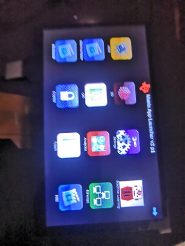

    I  am using Beagle bone black and trying to boot it with Processor SDK Linux using SD card. I am unable to boot it and below is the log.

  • From the boot log, u-boot and kernel looks started ok, but somehow waiting for rootfs "[ 1.191365] Waiting for root device PARTUUID=55c1f8d5-02..."
    Have you tried creating your SD card per the following instruction?
    software-dl.ti.com/.../Processor_SDK_Linux_create_SD_card_script.html
  • Hi ,
          Thanks for the response. I have created my SD card in windows by following below link.
    https://software-dl.ti.com/processor-sdk-linux/esd/docs/06_03_00_106/AM335X/linux/Overview/Processor_SDK_Linux_Creating_a_SD_Card_with_Windows.html
    Now it started booting up properly. my LCD is up now but i am not getting expected output in display...below are the related files.
    Image is not coming if i keep "straight" for blue-and-red-wiring and coming in mirror format after putting "crossed". Please guide me to proceed further.

  • It is good to know that u-boot and kernel boots up now on your board.
    I'm looping in my colleague on LCD display inquiry.
    I am wondering if you have referred to the following silicon errata: http://software-dl.ti.com/processor-sdk-linux/esd/docs/latest/linux/Foundational_Components/Graphics/AM3_Beagle_Bone_Black_Configuration.html. It would be helpful to understand your board configuration.
    Krunal
  • Hi Krunal....
                     Thanks for the useful link....I have followed and applied same configuration. I am getting mirror image of Matrix App launcher in my display.  Below are files and please let me know where i am missing...

    I am wondering if you could please share the output image. I am not sure what you mean by mirror image and I am assuming the color bars are flipped.
    Krunal
  • Please find the image
    I apologize but I do not understand what's wrong with the above image. I am wondering if you could please share more details
    Krunal
  • Hi Krunal.....Matrix app launcher coming as mirror image but now it is coming as expected.. Thanks
