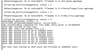

but output serial log shows me like this,
it says that GTC_CNTFID0 equals 0, i have no any clues why this happens , please help me to figure this out, many thx.

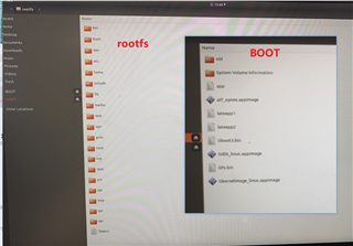

  • Hi Yan Yan,
    There was a typo in the documentation you are referring, instead of
    coresdk_rtos_jacinto_xx_yy_xx_bb/pdk_jacinto_07.x.x/packages/ti/boot/sbl/binary/$board/cust/bin/sbl_mmcsd_img_mcu1_0_release.tiimage, rename to tiboot3.bin
    it is
    coresdk_rtos_jacinto_xx_yy_xx_bb/pdk_jacinto_07.x.x/packages/ti/boot/sbl/binary/$board/mmcsd/bin/sbl_mmcsd_img_mcu1_0_release.tiimage, rename to tiboot3.bin
    Can you try the attached set of binaries? Replace them in the BOOT partition of your SD card.
    5226.BOOT.zip
    If these work then there is some issue with the setup on your side.
    Karan
  • Hi Karan,
    thanks for reply,
    i have replaced the binaries with yours, and then the output logs as below.
    please help me to figure this out that why linux boot failed.
    NOTICE:  BL31: v2.4(release):07.03.00.005-dirty
    NOTICE:  BL31: Built : 00:15:40, Apr 10 2021
    ERROR:   GTC_CNTFID0 is 0! Assuming 200000000 Hz. Fix Bootloader

    The logs show that the file system is not loading. Do you have a valid file system in the SD card?
    Karan
  • Hi Karan,
    Before I replace the files residing in BOOT partition, the system can start normally(uboot -> kernel);
    after i replaced the BOOT partition files, the system boot failed.
    i thought the file system should be valid.
    below picture shows the file structures in SD card.
    Yan
  • Hi Yan,
    With u-boot your parameters will be read from u-boot environment. With boot app there is no u-boot and hence the Device Tree is used for passing the boot args. Can you send you a patch on your Device Tree, what did you change on top of the SDK or did you not change anything?
    Karan
