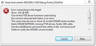

I am new to EVM C6748. When i run my C6748 LCDK in debugging mode, an error appears. I am using CCS v6.1.3.
For target configurations, i am using XDS100v2 USB Debug Probe in target configuration file.
I don't have any JTAG Emulator Debugger. For Debugging, i am using USB Debugging
Probe that come with LCDK.
I have searched a lot to find solution of this problem. But could'nt find any.
Please help me, how to solve this problem.
Error is:
    The C6748 LCDK does not have onboard emulator, as mentioned in the User's Guide, section 1.1 Features:
    • 14-pin JTAG header (No onboard emulator; external emulator is required)

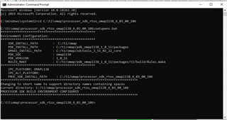

    I have run these commands that you mentioned. But I am facing an error. Please help me and provide the solution.
  • Also, I have tried by adding environment path variables found by running setupenv.bat command, in system environment variables. But still the error is not solved.
    The variables the I have added are:
    SDK_INSTALL_PATH : C:/ti/omap
    PDK_INSTALL_PATH : C:/ti/omap/pdk_omapl138_1_0_11/packages
    Please try to install the SDK to C:\ti instead of C:\ti\omap. Due to Windows limitation, directory path may be over the limit if you install the SDK to C:\ti\omap.
    Jianzhong

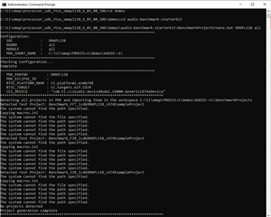

    I have tried by installing the OMAP SDK in the path that you mentioned, i.e C:\ti. But still the error remains same.
    The output of the commands is given below. Please suggest me what to do now. Thanks!!!

    C:\ti\processor_sdk_rtos_omapl138_6_03_00_106>cd demos/audio-benchmark-starterkit
    C:\ti\processor_sdk_rtos_omapl138_6_03_00_106\demos\audio-benchmark-starterkit>BenchmarkProjectCreate.bat OMAPL138 all
    Configuration:
    SOC : OMAPL138
    BOARD : all
    MODULE : all
    PDK_SHORT_NAME : C:\ti\PROCES~1\demos\AUDIO-~1\
    Checking Configuration...
    Complete
    PDK_PARTNO : OMAPL138
    PDK_ECLIPSE_ID :
    RTSC_PLATFORM_NAME : ti.platforms.evm6748
    RTSC_TARGET : ti.targets.elf.C674
    CCS_DEVICE : "com.ti.ccstudio.deviceModel.C6000.GenericC674xDevice"
    Detecting all projects in PDK and importing them in the workspace C:\ti\PROCES~1\demos\AUDIO-~1\\BenchmarkProjects
    Detected Test Project: Benchmark_FFT_lcdkOMAPL138_c674ExampleProject
    The system cannot find the path specified.
    Copying macros.ini
    The system cannot find the file specified.
    Detected Test Project: Benchmark_FIR_lcdkOMAPL138_c674ExampleProject
    Copying macros.ini
    Detected Test Project: Benchmark_IIR_lcdkOMAPL138_c674ExampleProject
    Copying macros.ini
    No projects detected
    Project generation complete
  • You need to use CCS 9.3 as mentioned in the Processor-SDK download page: https://www.ti.com/tool/download/PROCESSOR-SDK-RTOS-OMAPL138#downloads. Please download and install CCS 9.3 and try again.
