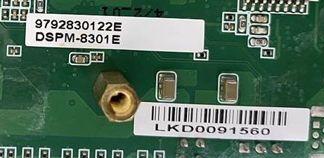

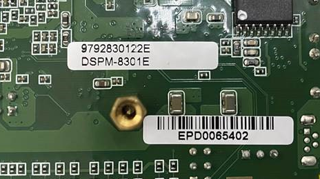

  • Dear Mukul,
    Please find more details on the problem which we are facing.
    We notice 2 different Revision (A and B) for these boards.
    Please find below photo of the serial number of the units based on the 2 variants in the Revision.
    At this moment, we are doing a test on the SRIO interfaces and are connected 2 boards in a loopback configuration.
    We have issues with this interfaces. We do not see any data flowing on this interface.
    We observe that the boards are loaded with different FPGA image ( which configures the clock generator chip).
    This is problem, because some peripheral will not work if clock generator is not configured correctly.
    Could you confirm on this?

  • Hi all,  c6678 EVM Board with version 3A gives problem in SRIO port initialization. The SRIO port is not operational when I run SRIO bench marking test between producer and consumer.  The same sw does not give port operational error in 3B revision of the board.. I am attaching the image of the 3A boards here. We have total 3 c6678 EVM Board with version 3A, all of them does not work.
  • Hi
    Thanks for the additional information , however we really need full model number, serial number and revision of each board.
    Can you also clarify where you purchased these from?

  • Dear Mukul,
    Please find below the part details we had recived against the order for TMDSEVM6678LE through ti.com
    Model# 9792830122E , DSPM-8301E :  S.No# EPD0065402, EPD0065405, EPD0065393, LKD0091560

  • Hi TI team,
    It is important for us to know the main difference between Rev3A and Rev3B boards. Can you let us know the differences between the 2 revisions?
    Please find pictures of the 2 boards variance for your feedback.
    Rev3A
    Rev3B

  • Hello Ibrahim, Sruthy
    We were able to track down the difference on rev 3A vs 3B.
    Rev  3B has the SR2.0 silicon (latest and what customers will go to production with). Rev 3A may have older SR1.0 silicon.
    https://www.ti.com/lit/er/sprz334h/sprz334h.pdf
    If you look at the errata, you will see how you can read some registers to confirm silicon revision. You will also notice that SR1.0 has several silicon errata around SRIO.
    So for stable development you need to be on SR2.0 silicon based EVMs.
