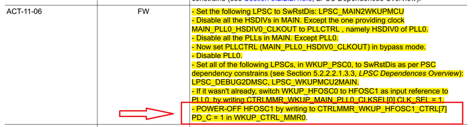

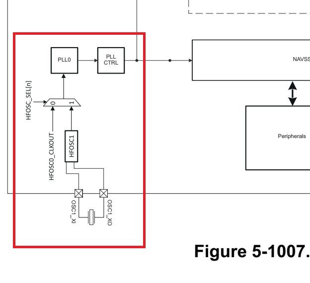

I am working on Jacinto 7 evm (TDA4VMXEVM)... I want to use external oscillator OSC1_XI/XO as main clock source for the main domain as shown in figure below.

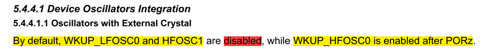

The Technical Reference Manual mentions that HFOSC1 is disabled by default:
In order to turn ON/OFF the CTRLMMR_WKUP_HFOSC1_CTRL[7] needs to be SET/RESET:
My Query:
1. I couldn't find CTRLMMR_WKUP_HFOSC1_CTRL register.
2. If I am wrong, how I can turn ON use External oscillator OSC1_XI/XO?
3. As shown in Pic#1 above, which register contains HFOSC_SEL[n]?
