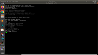

PROCESSOR-SDK-AM64X: Bad Linux image in uboot
Part Number: PROCESSOR-SDK-AM64X
TMDS64GPEVM, I'm booting from eMMC but it throws Bad Linux image
Environment variables
any advice ?
