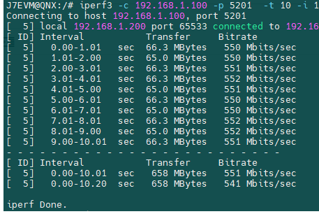

Hi experts:
I test mac2mac speed under QNX system . the  speed is not 1G only 500M but on linux the speed is up to 930M
then i check the patch
[FAQ] DRA829VXEVM: Is it possible to connect two DRA829 EVMs via SGMII - Processors forum - Processors - TI E2E support forums
i think QNX system need modify some parameter reference kernel_cpsw9g_virt_increase_rxtx_desc  - 256- > 500
Could you please introduce how to modfiy the  parameter at qnx system  ?
Best Regards!

    Thanks for your query.
    Yes, the QNX DEVNP CPSW9G virtual driver has a speed of ~550Mbps when test with the default "iperf -c <ipaddr>" option. But it can increase up to 900Mbps with "iperf -c <ipaddress> -w 128K". Suggest giving this a try.
    Regarding increasing the DMA descriptors from 256 to 500  is described below:
    Note that the driver today by default supports 128 descriptors for RX and 128 descriptors for TX. But this can increase to a MAX of 256 for both RX and TX respectively. This can be specified using the command line parameters when starting the driver.
    For example:
    io-pkt-v6-hc -d cpsw9g  tx_descriptor_cnt=256,rx_descriptor_cnt=256
    The different command line parameter options support by the driver can be using the command:
    use devnp_cpsw9g.so
    Hope this helps.
    Thanks.

    I read a lot of documents provided by QNX and Ti, and did not find the description of this parameter. Which document describes this parameter
    All the driver option supported can be looked at using the "use" command on the driver library. This is mentioned in the document link:
    4. PSDK QNX Components — Processor SDK QNX J721E (ti.com)
    Thanks.
