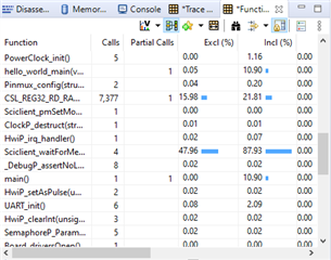

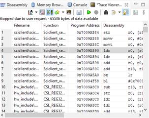

  • Hi Andreas,
    My solution works with 2-pin Trace Probe on CCS v10.3.1
    So:
    1. CCS just loaded, started. EVM boot should be in debug mode. Start required script to initilize all peripherals.
    2. Selected project must be successfully compiled. Load compiled program (.out) to selected CPU core.
    3. Debug execution cursor should be in program entry point (main() func). Choose starting and stopping brakepoints (for trace collection).
    4. Run program up to starting brakepoint.
    5. Activate trace collection (Tools->Hardware Trace Analizer->PC Trace). Choose transport type (560 V2 or else) according to acctual trace probe variant.
    6. Press Start. Trace Viewer is in collection enable state. Run code until it reaches next breakpoint.
    7. Trace data is collected, adiititonal statistical graphs can be viewed by pressing Analize buttion on the top left Trace Viewer window.
    Trace activation
