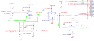

HI,
I'm working on a custom design based on TDA4 EVM. Looking at the reset signals, PORz is generated from some power goods and also PCIEx_PORz.
Looking deeper into how the PCIEx_PORz generates, it seems there is a case in which SOC_PORz_OUT drives low PCIEx_PORz which would drive low PORz when configured as root complex.
What is the reason behind this? From TRM PORz is the input and then PORz_OUT propagates that input to other devices, so if PORz_OUT drive PORz it seems that would hold the device in reset forever.
The relevant schematic portion:
David
