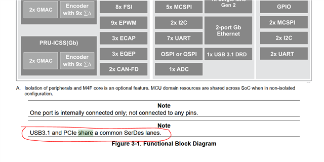

3, for AM6412, in datasheet, feature of “industrical communication subsystem support” is marked as “No”, I guess it means not support for “profibus”, “ethercat” …, how come? Is the PRU different between AM6412 and AM6442? Is the PRU in AM6412 has less RAM comparing with AM6442?
4, on datasheet, it specified that “USB3.1 and PCIe share a common SerDes lanes”, what is imply? Is it meaning that USB3.1 and PCIe cannot work simultaneously at the same time? Would you please elaborate what’s the impact of this “share a common SerDes lanes”? USB and PCIe can work at the same time, but share the same throughput bandwidth limited by this SerDes lane, maybe?

    I will let other experts answer your question 1-3, but I can take #4:
    This implies USB super-speed and PCIe cannot be used simultaneously.
    The SerDes is the PHY taking care of the Gbps transfers, so PCIe would require SerDes to function. But the USB module also has a USB2.0 PHY to support USB high-, full-, and low-speed. So you would have the following usecases:
    - PCIe + USB 2.0, or
    - USB 3.1 with no PCIe

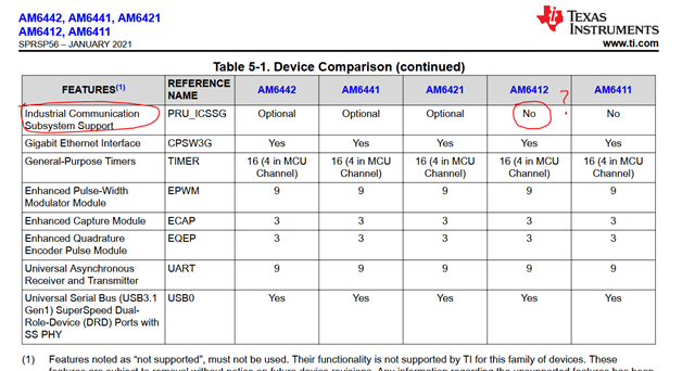

  • Hi JJD:
        We can see the datasheet,it is say that AM6412 has 2 PRU_ICSSG. like the follow picture. But the "Industrial Communication Subsystem Support" is "No", I want to know detail contain with here "Industrial Communication Subsystem Support" ?
    and detail contain with "Programmable Real-Time Unit Subsystem"?
  • Sorry for the confusion, i was incorrect earlier.  The AM641x devices do contain the PRU, but does not include support for ICSSG (industrial protocols).  The PRU can be used as a separate real-time processing unit in the AM641x devices.

  • Hi JJD:
        Thanks for your answer.
         I want to used AM641x deices to implement industrial general ether gateway, and I will need 5 gigabit ethernet port.
         So I used TI SysConfig tools config 5 gigabit ethernet port (1x CPSW and 4x pru-eth).
         "The AM641x devices do contain the PRU, but does not include support for ICSSG (industrial protocols). "
        Now, Can I used 4x pru-eth for  AM641x devices,?
       I can not find which part is ICSSG and which part is PRU at follow picture "PRU_ICSSG Functional Block Diagram".

    For protocols, networking, ICSS and PRU support the key is one letter in the part number, not the digits. See datasheet (https://www.ti.com/lit/gpn/am6442 ) table 10-1 and the description of part numbers. The part number in general is:
    aBBBBBBrZfYytPPPQ1
    The letter at location f I have highlighted in red determines the PRU and ICSS capability. The capability is in ascending order of capability. Gigabit is not separately enabled, if networking is there, the gigabit capability is there.
    C means just PRU, no ICSS networking
    D means ICSS-PRU is available and can run the networking firmware
    E means also EtherCAT capability is available
    F means the part will run the certified industrial protocol stacks that are provided by TI
    Note that not all possible permutations exist when combined with for example the core counts. For example the F part numbers always have 2 or more R5 cores.
    The evaluation modules always have the the superset F parts.
