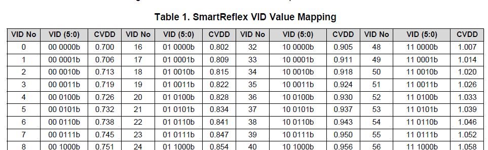

Are the value of SRVnorm which is described on the data sheet chapter5.3 for TMS320C6655.
and the value CVDD which is described at Table1 in https://www.ti.com/lit/an/sprabi2d/sprabi2d.pdf
same?
For example, it VID is programed with the value "0" after manufacturing tests, recommended operating condition of CVDD for TMS320C6655 is
min: 0.7 x 0.95
nom: 0.85-1.1
Max: 0.7 x 1.05
Is that correct?
