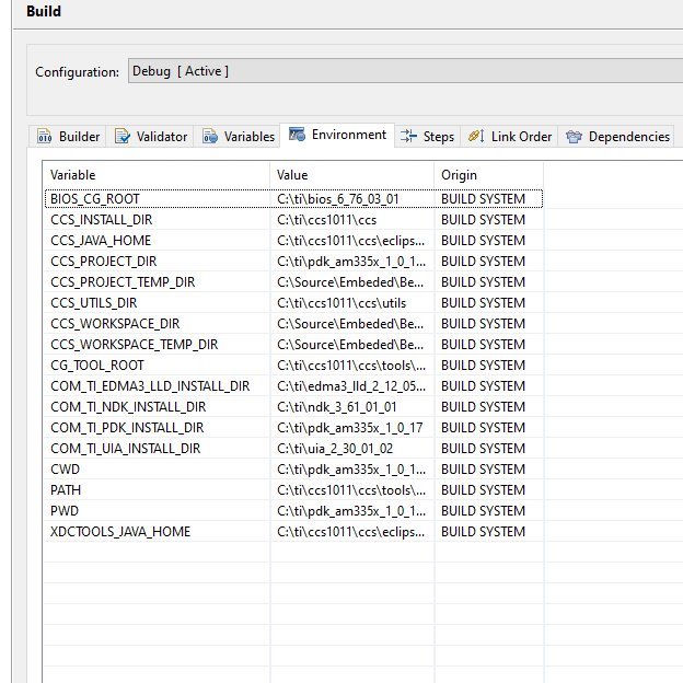

The POST BUILD step of the example app GPIO_LedBlink_bbbAM335x_armTestProject calls (using PDK 1.0.17 and CCS 10.1.1)
${TI_PDK_INSTALL_DIR}/packages/pdkAppImageCreate.bat
Where is ${TI_PDK_INSTALL_DIR} defined??
Because I've searched every place I can find, and the closest I come are values that have "COM_" slapped in front of them.
There is no ${TI_PDK_INSTALL_DIR}...   does this environment just arbitrarily slap "COM_" in front of SOME of the variables?

  • Hi Christopher,
    If your question is only limited to understanding from where TI_PDK_INSTALL_DIR  is getting defined. It is from the eclipse plugin:
    Example:
    plugins/com.ti.pdk.am335x.product_1.0.17/META-INF/MYKEY.SF:5:Created-By: 1.8.0_131 (Oracle Corporation)
    plugins/com.ti.pdk.am335x.product_1.0.17/plugin.xml:5: id="com.ti.pdk.am335x.product_1.0.17"
    plugins/com.ti.pdk.am335x.product_1.0.17/plugin.xml:14: <extension point="org.eclipse.rtsc.xdctools.ui.productInfo">
    plugins/com.ti.pdk.am335x.product_1.0.17/plugin.xml:15: <repository location="../../../packages"/>
    plugins/com.ti.pdk.am335x.product_1.0.17/plugin.xml:16: <docs location="../../../docs"/>
    plugins/com.ti.pdk.am335x.product_1.0.17/plugin.xml:18: installLocation="../../.."
    plugins/com.ti.pdk.am335x.product_1.0.17/plugin.xml:27: id="com.ti.pdk.am335x"
    plugins/com.ti.pdk.am335x.product_1.0.17/plugin.xml:30: rootMacroName="TI_PDK_INSTALL_DIR"/>
    plugins/com.ti.pdk.am335x.product_1.0.17/plugin.xml:35: productTypeId="com.ti.pdk.am335x"

    There are several of these arm-none-eabi-objcopy.exe files.   Which one is being called??
    It appears to be using the one in  ${TI_PDK_INSTALL_DIR}/packages
    My project DOES NOT EVEN SET THE PDK
    So.. How does it know to use the XML file you told me??   How does it know to use "C:\ti\ccs1011\ccs\eclipse\plugins\com.ti.pdk.am335x.product_1.0.17_1.0.17" ??
    Where in that XML file does it actually specify the folder...  WHICH arm-none-eabi-objcopy.exe to use??
    ( C:\ti\ccs1011\ccs\tools\compiler\gcc-arm-none-eabi-7-2017-q4-major-win32\bin or C:\ti\gcc-arm-none-eabi-7-2018-q2-update\bin ??)
    The one to use is coming from CG_TOOL_ROOT...   So where is THAT getting set from??  What is "BUILD SYSTEM"?   Because that isn't in the XML either.

    The CCS is based on eclipse project. It understands the eclipse plugins for the component. I do not know how much you would like to learn or you are required to learn about eclipse plugins etc.
    You can discuss details on eclipse plugins etc with CCS teams may be in a different thread.
    All the components under PDK are eclipse components, the RTSC search path discovers all these components and you can select the component you would like to use for your CCS project.
    If you pick PDK 1.0.17 for AM335x, it would have the path setup for compile until the base dir that is defined in the eclipse plugin.
    As far as the PDK is concerned, they undergo nightly regressions and tests and checks before release.
    If you are seeing something fundamental failing out of the box (release component without your tweaks), probably it may be your setup (most of the times).
    On the thread you referenced, you seem to look for how to setup entry point for TIRTOS, which other TI expert is working with you.
    So, As far as this thread is concerned, I think you can close the thread and you probably got the answer to how this variable value is set.
