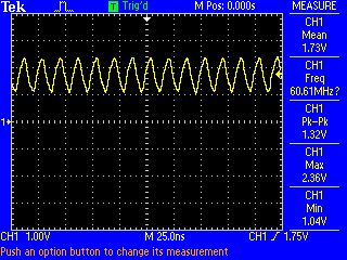

  • Here are the waveforms from our tests when we used a 60MHz clock, these failed.
    The waveforms look pretty much identical when run at 20MHz (just the time division is different and the clock line is able to produce a full swing from 0v-3.3v).  Other than that, the actual shape is exactly the same.
    I cannot provide you with the slower waveforms when the tests failed because probing the line causes the test to pass at 20MHz.
    Clock:
    Data pin [0] (LSB):
  • Thanks for the waveforms. These waveforms are not very useful at 60MHz since they only have around a 1.3V swing! It would probably be more useful to see the passing waveforms at 20MHz, with the clock and date both captured on the same screen (so we can see how marginal the setup/hold times are.

  • Hi srirami,
    Thank you for following up with me.  We were able to figure out the problem.  We were using high-speed high-current FETs on the FPGA to drive the signal.  When we used slow, lower current FETs, we were able to drive the signal properly.  At least at 20MHz.  We are still experimenting with 60MHz.
