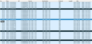

I have tried setting the schedule as described in "example schedule" section of the following web page,
https://software-dl.ti.com/jacinto7/esd/processor-sdk-linux-j7200/07_03_00_04/exports/docs/j7200/linux/Foundational_Components/Kernel/Kernel_Drivers/Network/CPSW2g.html#enhancements-for-scheduled-traffic-est-offload

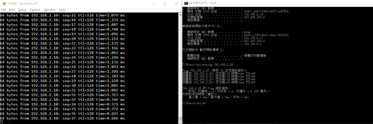

(1)Before The EST demo, I try to ping EVM(leftside,IP:192.168.2.20) CPSW2g eth port from my NB eth port(rightside: IP: 192.168.2.10) as following, it's OK to ping each other.
(2) Then I try to  run the steps to configure this schedule, EVM linux cmd window shows :unable to connect to server : Connection time out
And in Wireshark log message show TCP Retransmission .
Could you point me to what I have to do to fix this error?
    I have tried this myself and it works. Can you log your session (commands you are running) and post here ? Sometimes if the sequence (to program schedule) isn't executed correctly or there is some other error then this happens.
    Vineet
  • Hi Vineet
    I have tried again and ti works, but test result in wireshark shows: schedule time (TC0@port 5001:6us /TC1@port5002:32us / TC2@port5003:64us) are not fit taprio setting (250us/125us/125us), also the cycle time in only 168us< (500us),
    Could you show you TAS test result? is same as the demo?
    Could you point me to what I have to do to fix this issue?

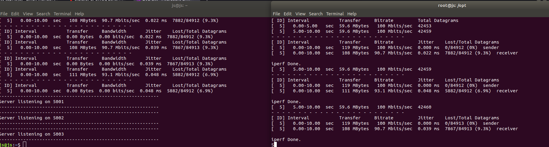

    iperf3 test  result as following:left side is remode pc, right side if J7200_EVM
    BR
    JAY
  • Hi TI
    We have tried again in others J7200EVM and PC, it is same result as before
    TAS Gate control time  or cycle time is not same as tc taprio  setting

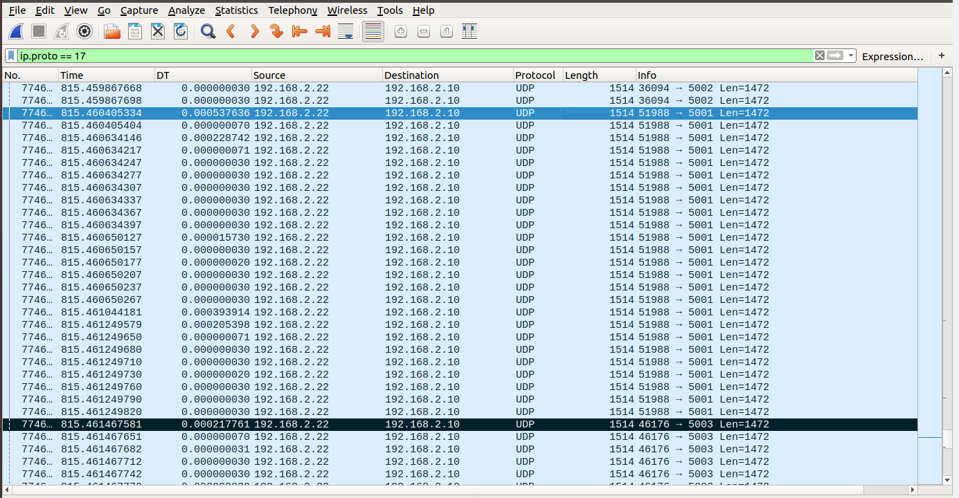

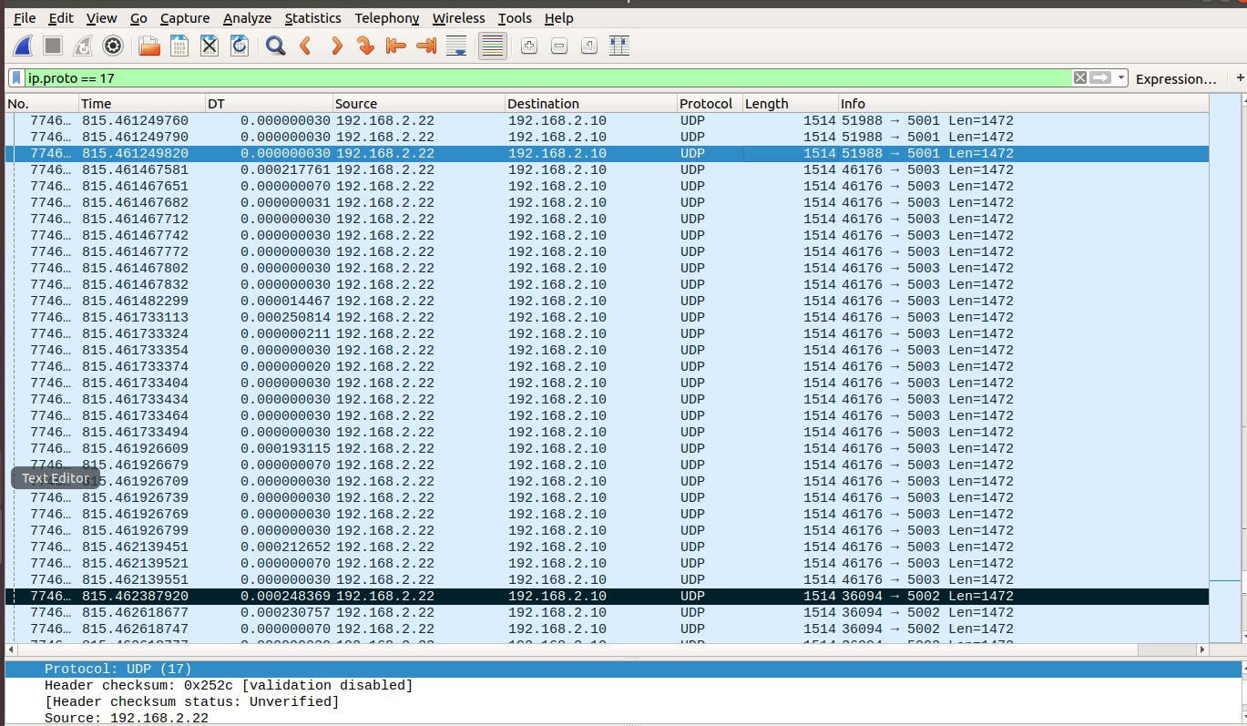

  • HI Vineet
    We have tried modify duration of Gate open time(125us/125us/250us=>1ms/1ms/1ms)  by change taprio  sched-entry setting
    the test result TAS Gate control time  and cycle time are almost same as tc taprio  setting
    What meaning for this scenario? It means TAT gate control time been limited?

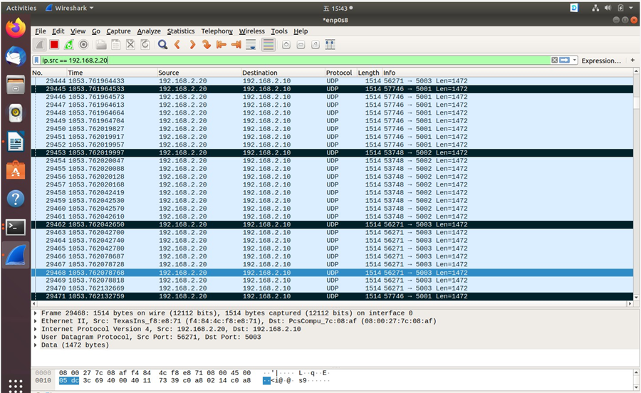

  • Hi Vineet
    We move to  DRA821 EVM running 8.0 Linux SDK
    Wireshark test result show same issue, gate timing still  different with Gate Control List

    (3) Wireshark log

  • Hi Jay,
    Similar to my comment on the other TSN thread
    I found out that the TSN features (EST and IET) for CPSW 2G were never actually tested on J7200. It got added because the support was added for another SoC (AM65 and AM64) and since the IP is identical on all three, it was added to the documentation.
    I don't think it makes sense to debug this issue here until official support is added, which will be in Q4 2021 (SDK 8.1). I will close this ticket for now and we can re-visit this post SDK 8.1
    Apologies for any confusion.
