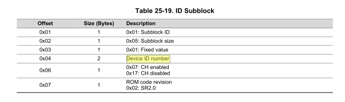

Customer needs Device ID (part of ASIC ID) for DRA78x derivates (Value is missing on TRM):
Please can you share?

Hi Marcus
2 bytes for device ID will be 0x41 and 0x4C
