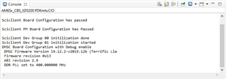

PLL3 initalization is correctly done when connecting to the M3 DMSC core.
However, problem is that upon loading DMSC fw DDR PLL is again set to 400MHz.
I tried creating functions in Gel files AM65xEVM.gel and M4_PLL to set PLL3 again to 333MHz before DDR initalization is performed but this is not done correctly (I suppose that SYSFW is preventing this change).
Is there any way to set PLL3 in this case (when using configuration via emulator) without modifying SYSFW?

    It is coming from "sciclient_ccs_init_mcu1_0_release.xer5f" which is loaded from "launch.js". The example is given under "/sciclient/example/sciclient_ccs_init/sciclient_ccs_init_main.c. You can modify the "CSL_DDR_PLL_CLK_FREQ" to your required frequency and build the example, then replace the binary. It will work.
  • Hello Akash,
    Yes this seems to be the issue. I modified sciclient_ccs_init_main.c and PLL3 clock is correctly set now to 666MHz and I can load and run the code from LPDDR4 now. We will test LPDDR4 extensively now in the following days but it seems to work without problems.
