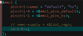

The customer uses a customized board. The difference between the customized  board and TMDSEVM572X is that customized  board has only 1G memory, the default network port is eth1, and other peripheral connections are the same.
So customer modified the memory of uboot to 1G and the network port to eth0, recompiled to generate MLO and u-boot.img, replaced the file of the same name in the sd card boot, and didn't make any changes to the rootfs partition. After booting up, kernel stuck in waiting for root device PARTUUID=7a61ff61-02...
Below is the boot log:

  • Hi Nancy,
    How is the SD card created? Did you use the create-sdcard.sh script under the bin folder of the SDK?
    Could you please try that script and see if that helps with the issue you are facing?
    - Keerthy
    Customer has created with create-sdcard.sh before, but the system stuck at uboot stage.
  • Hi Nancy,
    Create the card using create-sdcard.sh - That will have default 2GB supporting MLO/u-boot.img. Replace them
    with your custom MLO/u-boot.img that boots. That should help solve this.
    - Keerthy
  • So customer modified the memory of uboot to 1G and the network port to eth0, recompiled to generate MLO and u-boot.img, replaced the file of the same name in the sd card boot, and didn't make any changes to the rootfs partition. After booting up, kernel stuck in waiting for root device PARTUUID=7a61ff61-02...
    Customer has changed configuration according to the board.
  • Hi Nancy,
    vmmc-supply = <&vdd_3v3>;
    vqmmc-supply = <&ldo1_reg>;
    Can they remove the above properties from the mmc1 node? This should disable UHS in case that is causing
    the sdhci failures seen above in the boot logs shared,
    Keerthy
    Customer removed out vqmmc-supply in the am57xx-beagle-x15.dts file (the vmmc-supply of mmc1 was not found in other related device trees), regenerated the device tree, and copied it to the boot directory of the SD card rootfs partition. The kernel reports an error, please see below log:
    U-Boot SPL 2019.01-g323d51410c-dirty (Jun 23 2021 - 10:23:14 +0800)
    DRA752-GP ES2.0
    Trying to boot from MMC1
    Loading Environment from FAT... OK
    U-Boot 2019.01-g323d51410c-dirty (Jun 23 2021 - 10:23:14 +0800)
    CPU  : DRA752-GP ES2.0
    Model: TI AM5728 BeagleBoard-X15
    Board: UNKNOWN(BeagleBoard X15?) REV UNKNOWN
    DRAM:
    ---xie---arch/arm/mech-omap2/emif-common.c/1520 --- sdram_init()
    1 GiB
    MMC:   OMAP SD/MMC: 0, OMAP SD/MMC: 1
    Warning: fastboot.board_rev: unknown board revision

  • Hi Nancy,
    That was basically to avoid UHS modes. regulator_set_voltage is failing. I will check internally & get back to you.
    Keerthy
  • Is it certain that the problem must be related to SD card?
    I have checked the SD card circuit, the schematic is the same as Ti's(BEAGLEBOARD_X15_REV_B1.pdf).
