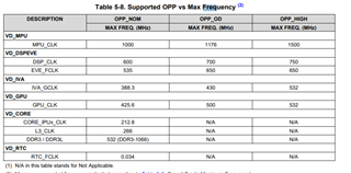

Is it possible to run MPU at 500Mhz in AM5728?
My customer tried to set lower clock set in A15 and DSP when thermal issue was occurred.
But, when my customer tried to set A15 at 500Mhz by referring below, they could not find any difference in the performance with 800Mhz and want to get details how they can set it.
https://software-dl.ti.com/processor-sdk-linux/esd/docs/06_03_00_106/linux/How_to_Guides_Linux_Porting_Guide_AM571x_AM570x_Speed_Grades.html
And also, is it possible to re-set CPU clock of A15 and DSP at runtime when thermal issue was occurred?
And in the kernel setting, they found 'CPU Power Management > CPU Freq governor' menu and they want to know details how it works. Could you please help to resolve these 3 questions?

    If you are using the 6.03 SDK there is already  thermal framework in place that should reduce the frequency upon detecting high temperatures.
    How are you reducing the frequency to 800MHz? Are you changing the OPP table in device tree?
    A15 is possible but DSP is fixed.
    Also data sheet:www.ti.com/.../am5728.pdf
    So 500MHz is not supported for AM5728.

    it seemed there were only OPP_NORM, OPP_OD operate when I checked below.
    Is there any way to use max frequency of 1.5Ghz in AM5728?
    When my customer set scaling_governor to 'performance', they found it runs at 1.5Ghz as below.
    Can they use this for their high-performance processing?
    cat /sys/devices/system/cpu/cpu0/cpufreq/scaling_governor
    performance
    cat /sys/devices/system/cpu/cpu0/cpufreq/cpuinfo_cur_freq
    1500000
    The max freq in each OPP described in datasheet is 'MAXIMUM', right?
    is it OK to use 500Mhz in AM5728 MPU to reduce heat dissipation when thermal issue will be occurred?
    I found there was only change between OPP_NORM and OPP_OD in our thermal framework document.
    But, they can set it to 500Mhz as below.
    Can they use below mode to reduce heat dissipation efficiently?

    500MHz is not mentioned is the Data sheet for AM578. So you could try but
    the device will not be characterized for that frequency.
    Also for 1.5GHz. This is the below definition for am5728:
            cpu0_opp_table: opp-table {
                    compatible = "operating-points-v2-ti-cpu";
                    syscon = <&scm_wkup>;
                    opp_nom-1000000000 {
                            opp-hz = /bits/ 64 <1000000000>;
                            opp-microvolt = <1060000 850000 1150000>,
                                            <1060000 850000 1150000>;
                            opp-supported-hw = <0xFF 0x01>;
                            opp-suspend;
                    opp_od-1176000000 {
                            opp-hz = /bits/ 64 <1176000000>;
                            opp-microvolt = <1160000 885000 1160000>,
                                            <1160000 885000 1160000>;
                            opp-supported-hw = <0xFF 0x02>;
                    opp_high@1500000000 {
                            opp-hz = /bits/ 64 <1500000000>;
                            opp-microvolt = <1210000 950000 1250000>,
                                            <1210000 950000 1250000>;
                            opp-supported-hw = <0xFF 0x04>;
    So 1.5GHz is supported already.
    The documentation is not updated but we do support 1.5GHz already as shown above.
