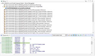

  Our company wants to develop programs on the TDA4 board, and the development environment is QNX+RTOS.
  We want to judge whether arm enters WFI or WFE mode in the program.
  Is there any way to judge whether arm enters WFI or WFE mode?
  Thank you!
    I'm sure there are multiple ways to do it.
    One possibility is hooking up the CCS debugger using the built-in XDS110 on the EVM, and connecting to the 2nd A72 core.
    On a system that has low usage the 2nd A72 is likely to be idle.
    In this case when viewing the program counter in the dis-assembly view, the WFI can be seen.
