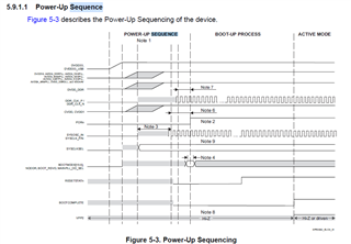

Hi I am designing my board with the Ti SOC 66ak2g12
The datasheet states that the SOC power up sequence is as this order (using figure 5-3) :
3.3V (DVDD33) then 1.8V,1.0V DDR and Core voltage.
The Artix family of FPGA by Xilinx requires the opposite sequence first FPGA core1.0V,  then 1.8V_AUX and lastly the 3.3V I/O.
  • I see two options that can be to power on the SOC+  FPGA :
    1. 0VFPGAcore ->1.8V FPGA_Aux -> 3.3VFPGA and_SOC_IO -> 1.8VDDR+1.0VSOC_core
    2. 3V_SOC_IO(only) -> 1.8VDDRand FPGA_AUX+1.0V_SOC_core ->3.3V FPGA_IO(only)
Both option have possibility of leakage voltage that will cause the power up to be from certain voltage and not from 0V. (for example the in B, before turning on the FPGA 3.3V IO the FPGA will have ~~2.3V.
Similarly in option a I fear that the SOC might have leakage voltage on the 1.8V and core voltage before turning them on. (That leakage will come from the FPGA IOs connected to SOC)
Please advise  at what order do you recommend to perform the power up/ down sequence ? and your comments on the above.

  • Power sequencing is a system level concern where the designer must understand limitations of all on-board and all off-board attached devices. 66AK2G12 requires the 3.3V supplies to be turned on before any of the other supplies, but there is no specific requirement associated with sequencing of the other supplies.
    I assume a few 66AK2G12 IOs will be connected to FPGA IOs. If so, the respective IOs of each device should be powered from a common IO supply. A common supply is necessary because the 66AK2G12 IOs are not fail-safe and I suspect the same is true for the FPGA IOs. Sourcing the IOs with a common power supply eliminates the risk of one IO sourcing a potential to the attached IO before it receives power.
    If the above is true, I feel your option #1 would be best for your system. However, this prevents you from sharing a 1.0V and 1.8V power rail with 66AK2G12 and FPGA since one must be sequenced on/off before the other. This will require separate 1.0V and 1.8V supplies for 66AK2G12 and FPGA.
    You mention option B and option A in your description. I assume option A is the same as #1 and option B is the same as #2. If so, I agree option B would be problematic as the IOs of 66AK2G12 is likely sourcing a potential to the FPGA IOs before it is powered and current will flowing through the ESD protection circuit of each FPGA IO to the FPGA IO power rail. This condition may cause a long-term reliability issue for the FPGA.
    I do not understand your concern with option A (#1) as long as you provide separate supplies for the 66AK2G12 and FPGA 1.0V and 1.8V power rails.
    You will need to make sure there are no other devices in your system that cross a voltage domain and cause a problem.
    I’m not aware of an application note that addresses these concerns as they are very system implementation dependent.
    The power sequencing recommendation for 66AK2G12 is sequential with respect to the 3.3V supply turning on before any of the other supplies.
