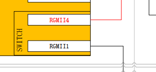

I am using the hardware scheme as shown in the picture below on DRA821. I would like to know how I should modify it to support such two RGMII scenarios.
RGMII1 is connected with a switch chip, RGMII4 is connected with a phy chip.

    I would like to know whether the connection scheme in our picture can realize the use of Ethernet under UBoot.
    Because I saw the previous design and demo board in the UBOOT phase of the use of the network are MCU_RGMII connected out.
    I do not see MCU_RGMII1 pins in this picture. That's what you need for enabling ethernet under Uboot
    Vineet
  • Hi Vineet:
    This is my question, if you want to use Ethernet under UBOOT words can only use MCU_RGMII1 external chip to achieve?
    I can see from the PCB drawing provided by our hardware engineer that we use DRA821_RGMII4 in the above picture to external connect PHY chip.
    So I want to confirm that this scheme is not able to meet the requirements of using Ethernet under UBoot.
    Thanks.
  • Supplement a picture of our scheme.
    That's right. You cannot do Ethernet under Uboot with this.
    DRA821_RGMII4 is for CPSW 5G
    Vineet

    +    /* MyRGMII4 -> RGMII4_TD3 -> T18 */
    +        PIN_UART1_RXD, PIN_MODE(4) | \
    +        ((PIN_PULL_DISABLE) & (~PIN_PULL_DIRECTION & ~PIN_INPUT_ENABLE))
    +    /* MyRGMII4 -> RGMII4_TXC -> T16 */
    +        PIN_UART0_RXD, PIN_MODE(4) | \
    +    /* MyRGMII4 -> RGMII4_TX_CTL -> T20 */
    +        PIN_UART1_TXD, PIN_MODE(4) | \
    +    {PINMUX_END}
     static pinmuxModuleCfg_t gRgmiiPinCfg[] =
    -    {2, TRUE, gRgmii2PinCfg},
    +    {1, TRUE, gRgmii1PinCfg},
    +    {4, TRUE, gRgmii4PinCfg},
         {PINMUX_END}
     static pinmuxPerCfg_t gSystem0PinCfg[] =
         /* MySYSTEM1 -> EXTINTn -> U6 */
    @@ -236,29 +273,6 @@
         {PINMUX_END}
    -static pinmuxPerCfg_t gUart3PinCfg[] =
    -    /* MyUART3 -> UART3_RXD -> Y18 */
    -        PIN_MCAN2_TX, PIN_MODE(11) | \
    -        ((PIN_PULL_DISABLE | PIN_INPUT_ENABLE) & (~PIN_PULL_DIRECTION))
    -    /* MyUART3 -> UART3_TXD -> Y19 */
    -        PIN_MCAN2_RX, PIN_MODE(11) | \
    -        ((PIN_PULL_DISABLE) & (~PIN_PULL_DIRECTION & ~PIN_INPUT_ENABLE))
    -    {PINMUX_END}
    -static pinmuxModuleCfg_t gUartPinCfg[] =
    -    {3, TRUE, gUart3PinCfg},
    -    {PINMUX_END}
     static pinmuxPerCfg_t gWkup_i2c0PinCfg[] =
         /* MyWKUP_I2C0 -> WKUP_I2C0_SCL -> F20 */
    @@ -284,12 +298,10 @@
     pinmuxBoardCfg_t gJ7200_MainPinmuxDataCpsw[] =
         {0, gDebugssPinCfg},
    -    {1, gGpioPinCfg},
    -    {2, gI2cPinCfg},
    -    {3, gMdioPinCfg},
    -    {4, gRgmiiPinCfg},
    -    {5, gSystemPinCfg},
    -    {6, gUartPinCfg},
    +    {1, gI2cPinCfg},
    +    {2, gMdioPinCfg},
    +    {3, gRgmiiPinCfg},
    +    {4, gSystemPinCfg},
         {PINMUX_END}
    Index: ti/drv/enet/examples/utils/V1/enet_appboardutils_j721e_evm.c
    --- ti/drv/enet/examples/utils/V1/enet_appboardutils_j721e_evm.c	(revision 2630)
    +++ ti/drv/enet/examples/utils/V1/enet_appboardutils_j721e_evm.c	(working copy)
    @@ -214,8 +214,7 @@
         uint32_t clkModuleId[] = { TISCI_DEV_DDR0,
                                    TISCI_DEV_TIMER12,
                                    TISCI_DEV_TIMER13,
    -                               TISCI_DEV_UART2,
    -                               TISCI_DEV_I2C0, };
    +                               TISCI_DEV_UART2,};
         appFlags = 0U;
         moduleCnt = ENET_ARRAYSIZE(clkModuleId);
    @@ -291,8 +290,13 @@
                 switch (portNum)
                     case ENET_MAC_PORT_1:
    +#if defined(ENETAPPUTILS_BYPASS_QSGMII)
    +					/* RGMII port, set correct PHY address */
    +					phyAddr = 2U;
    +#else
                         /* QSGMII port */
                         phyAddr = 16U;
    +#endif
                         break;
                     case ENET_MAC_PORT_2:
    @@ -312,8 +316,13 @@
                         break;
                     case ENET_MAC_PORT_4:
    +					phyAddr = 0U;
    +#else
                         /* QSGMII port */
                         phyAddr = 19U;
    +#endif
                         break;
                     default:
    @@ -544,7 +553,7 @@
         else if (enetType == ENET_CPSW_5G)
    -        EnetAppUtils_assert(portNum == ENET_MAC_PORT_2);
    +        EnetAppUtils_assert(portNum == ENET_MAC_PORT_1 || portNum == ENET_MAC_PORT_4);
             /* Override the ENET control set by board lib */
             EnetBoard_setEnetControl(enetType, 0U/* instId */, portNum, RGMII);
    @@ -606,7 +615,7 @@
             case ENET_CPSW_5G:
                 /* Use RGMII port in GESI board when QSGMII is disabled */
    -            if (ENET_MAC_PORT_2 == portNum)
    +            if (ENET_MAC_PORT_1 == portNum || ENET_MAC_PORT_4 == portNum)
                     EnetBoard_setPhyConfigRgmii(enetType,
                                                         portNum,
    Index: ti/drv/enet/examples/utils/makefile
    --- ti/drv/enet/examples/utils/makefile	(revision 2630)
    +++ ti/drv/enet/examples/utils/makefile	(working copy)
    @@ -29,11 +29,12 @@
       ifeq ($(APPUTILS_TYPE),full)
         MODULE_NAME = enet_example_utils_full
         ENET_CFLAGS += -DENETAPPUTILS_UART_ALLOWED
    +	ENET_CFLAGS += -DENETAPPUTILS_BYPASS_QSGMII
       else
         ENET_CFLAGS += -DSDK_6_2_CORE_SDK_IMAGE
         ifeq ($(CORE),$(filter $(CORE), mcu2_0))
    -      #ENET_CFLAGS += -DENETAPPUTILS_BYPASS_I2C
    +      ENET_CFLAGS += -DENETAPPUTILS_BYPASS_I2C
           ifeq ($(SOC),$(filter $(SOC), j721e))
           endif
    @@ -40,6 +41,9 @@
           ifneq ($(SOC),$(filter $(SOC), j7200))
           endif
    +	  ifeq ($(SOC),$(filter $(SOC), j7200))
    +      endif
         else
         endif

    I read some Rtos code and it seems that DP83867 is supported by default.If I want to support an on-board Ethernet chip BCM89836 and a switch chip SJA1105P like this in my board, how do I modify the support?
    Thanks.
    Are you still looking for a solution to this problem ? CPSW 5G cannot be enabled under Uboot because of SW architecture and there are no immediate plans to enable this.
    If you use Linux kernel then you can any 3P switch or ethernet PHY
    Vineet
