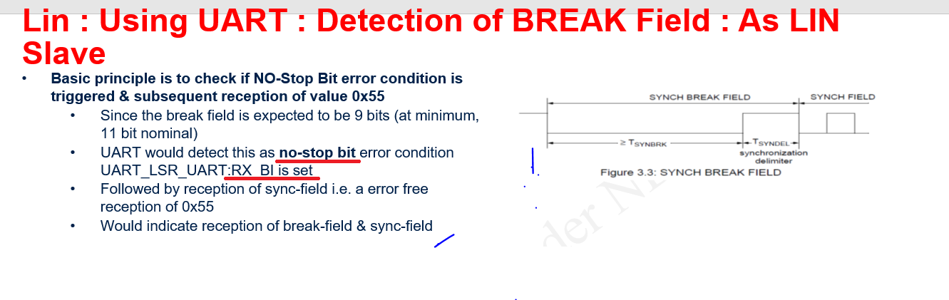

Customer try to design LIN driver with UART I/F.
Would you please help clarify how to detect break field as no-stop bit error condition?
tried to let external device to send break field like 960us. there is no-stop bit error happened.
thank you!
