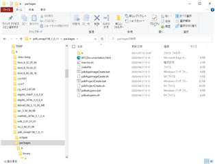

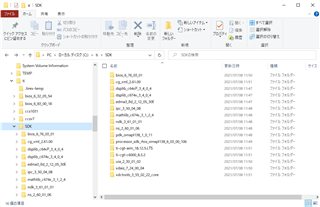

  • Please try project GPIO_LedBlink_lcdkOMAPL138_c674xTestProject.
  • Hi Jianzhong.
    I could not find that project in the SDK.
    The following figure shows the folder where I installed the SDK.
    In which folder is the project located?
    Thank you for your time.
    Suzuki
  • Hi Suzuki,
    You need to create the projects according to step 2 which I provided earlier:
    2. create PDK example projects according to instructions here.
    Jianzhong
  • Hi Jianzhong.
    Are you referring to "1.4.5. Rebuilding Components" in the "Processor SDK RTOS Getting Started Guide"?
    I got as far as running "pdkProjectCreate.bat", but it didn't create the sample project because there is no MyExampleProjects.
    Isn't it possible to create a sample project with C6748?
    Thank you very much for your help.
    Suzuki
