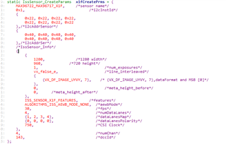

The driver config:

  • Thanks for your reply.
    1, by default, single cam example assumes lane speed s 1.6Gbps. Could you please check if this is what your sensor/deserializer is outputting?
     ==> The lane speed is 750 Mbps.
            The driver config as shown in the figure.
    2, Please check if lane position, polarity and number of lanes are matching as per the HW
    ==>  We matching 4 lans as per  the HW.  and I was used other the same deserializer sensor ,same out port ,
    and then run same vx_app_single_cam.out , the soc was can received Data packet. Does this mean that the whole of path from camera to SOC is good? but i was changed this current sersor can't received packet.
    3, Please check if data type is UYVY in sensor/deserializer and also use the same virtual channel id as configured in camera/deserializer.
    ==> We used mipii analyzer test sensor and i  was discovery that data type is YUV422_8bit(0x1E). and the corresponding code data type should be {VX_DF_ IMAGE_UYVY,  7 }.
    4, Please make sure to start the sensor/deserializer only after VerifyGraph is called. In Imaging component, this is taken care by starting deserializer and sensor in streamon callback. It must not be started before this.
    ==>My code configure sensor/deserializer  on  PowerOn function and the open mipii flow in StreamOn function  in driver. So I think it accord  the requirements.  because i will changed other same deserializer/sensor init register, and run same vx_app_single_cam.out  can recived packet.
    Are there any other possible problems?
    Thanks.Looking forward to your reply.

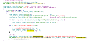

    I think single camera example does not use CSI lane speed variable, so even if you have set this variable to 750, CSIRX would still be configured for 1.6GBps. Can you please change add below statement
    local_capture_config.instCfg[id].laneBandSpeed = TIVX_CAPTURE_LANE_BAND_SPEED_720_TO_800_MBPS
    in below loop
    for(id = 0; id < local_capture_config.numInst; id++)
    local_capture_config.instId[id] = id;
    local_capture_config.instCfg[id].enableCsiv2p0Support = (uint32_t)vx_true_e;
    local_capture_config.instCfg[id].numDataLanes = sensorParams.sensorInfo.numDataLanes;
    for (lane = 0; lane < local_capture_config.instCfg[id].numDataLanes; lane++)
    local_capture_config.instCfg[id].dataLanesMap[lane] = lane + 1;
    for (q = 0; q < NUM_CAPT_CHANNELS; q++)
    ch = (NUM_CAPT_CHANNELS-1)* id + q;
    local_capture_config.chVcNum[ch] = q;
    local_capture_config.chInstMap[ch] = id;
    in the app_create_graph API?
    Brijesh
    I was changed your provide code. but it still  can't  received packet. What do I need to change code ?
    Thanks for your support and Looking forward to your reply.
    change code:
    log:

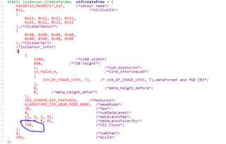

    You said that some other sensor is working fine, is it with the same deserializer? Are you just changing the sensor? If one sensor is working and other not, then yes, deserializer to csi2 input is fine.
    Are you sure then that configuration for the non-working sensor is correct? Can you check in deserializer status register it is receiving some data from the sensor?
    Brijesh
  • Hi Brijesh Jadav,
    Thank you for your reply.
    ====> Yes.  it is the same  deserializer ,same port , the same lane and Only change  cameraA  to cameraB module  for HW.
                         I was changed the deserializer/serializer init script and the soc high/width config for SW.
    ====> Yes. One sensor is working and other not.
    ====> This picture is We used mipii analyzer test sensor.   The camera firm said it was good,
    And i was read  deserializer status register for log for this.:
    The serializer  register status is 0x70 ,is right
    The DE/HS/VS register status  is right.
    I found the mipi portA reigister have data packet. the reigster is variable. It shows that have data passing through Mipi channel.

    I was sjust  tested it on the development board. it can't received data packet.
    I want to know has special requirements for received data?
    Thanks.
    Nothing specific requirement, we just need to make sure that the format, lane speed, number of lanes etc parameters are matching with the output from deserializer. If they are matching, it should be able to detect input stream and capture it.
    Can you please check in the application that it is using correct virtual channel id and data type? Since you are using yuv422 output, it should be configured for YUV422 data type, not raw data type.
    Brijesh
  • Thanks.
    It is sensor/deserializer script error ,so I was fixed and then run  working.
  • Do you mean it is working fine now and you are able to capture from sensor now?
    Could you please share the changes in the sensor layer in order to get it working?
  • I was changed Virtual transmission channel for sensor deserializer script.
