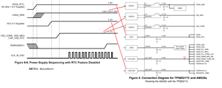

I compared Powering the AM335x with the TPS65217x . (Rev. I) with AM335x datasheet power sequence, found LDO3(1.8V) and DCDC1(1.5V) sequence of TPS65217C doesn't meet AM335x requirement. which is right? Beaglebone Black follow document of powering the AM335x with the TPS65217x design.

  • The issue is addressed in the PMIC app note, here.
    VDDS is ramped up before VDDS_DDR to avoid a problem with the sequencing. RTC-only cannot be supported with C and D versions as VDDS and VDDS_RTC are tied together to address the VDDS_DDR sequencing
    "TPS65217C is also targeted at the AM335x processor in the ZCZ package, but the DCDC1 output voltage is set to 1.5 V to supply DDR3 memory. This version does not support AM335x RTC-only operation."
  • Colin,
    I agree to connect 1.8V RTC and VDDS 1.8V together if doesn't use RTC only feature, my question is I did not find a power sequence figure in data sheet with  a 1.8V ramp up after VDDS_DDR(1.5V)
    From TPS65217C power sequence, the LDO3 1.8V ramp up after DCDC1 1.5V. And in datasheet, did not separate VDDS 1.8V and other 1.8V, but in the TPS65217 separate 1.8V to VDDS, RTC and VDDSHVx etc. VDDS and VDDS_RTC ramp up before VDDS_DDR, rest 1.8V ramp up after VDDDS_DDR.
    Please point me which power supply sequencing figure in AM335x datasheet follow the TPS65217 PMIC app note.

    This workaround issue for this specific SoC+PMIC solution is not captured in the AM335 datasheet. The Power-Up Sequence for TPS65217C in Figure 6 and Table 6 of the App Note provides the timing diagram for the work around.

    The work around essentially is that VDDS and VDDS_RTC are tied together to address the VDDS_DDR sequencing issue.

    I am not asking the VDDS_RTC, I am asking in the user guide there is a 1.8V rail(LDO3) ramp up after VDDS_DDR (DCDC1). I did not find such a power sequence in AM335x datasheet. Please just comments on this point.
  • Hi Tony,
    I'm an Apps engineer supporting the TPS65217C PMIC. Having the 1.8V rail (LDO3) ramping up after VDDS_DDR (DCDC1) or vice versa doesn't violate the AM335x spec. They just both need to be high before the 3.3V rail starts ramping up. We generally avoid ramping up two rails at the same time for in-rush reduction and that's why you don't see them ramping up together in the TPS65217 documentation.
    But I did not find such description or figure in AM335x datasheet. maybe it is in some corner comments. would somebody point it to us.
  • Hi Tony,
    The response to this latest question was provided by email. The processor sequence does not have a requirement for timing for 1.8V supplies vs. VDDS_DDR, they are in the same time slot and either can be powered up first/second.
