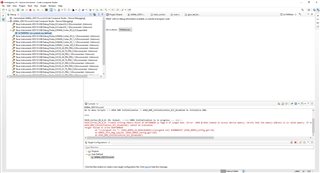

I was following the AM64x MCU+ SDK  07.03.02 getting started guide when I was frontend by the error you can see on the picture below.
It occured on the DDR Initialization step when I was supposed to  run the AM64_DDR_Initialization_EEC_Disabled script.
I followed all the prior steps. Does anybody know why this error occurs and what possibilities are there to solve? Thanks!

  • Hi
    Yes, this is where I get the error.
    MAIN_Cortex_R5_0_0: GEL Output: --->>> DDR4 Initialization is in progress ... <<<---
    MAIN_Cortex_R5_0_0: Trouble Writing Memory Block at 0xf300020 on Page 0 of Length 0x4: (Error -1065 @ 0x0) Unable to access device memory. Verify that the memory address is in valid memory. If error persists, confirm configuration, power-cycle board, and/or try more reliable JTAG settings (e.g. lower TCLK). (Emulation package 9.3.0.00058)
    AM64_DDR_Initialization_ECC_Disabled() cannot be evaluated.
    Target failed to write 0x0F300020
         at *((unsigned int *) (AM64_DDRSS_SS_BASE+0x020))=(unsigned int) 0x000001EF [AM64_DDRSS_Config.gel:34]
         at DDRSS_Init_Reg_Copy(0) [AM64_DDRSS_Config.gel:129]
         at AM64_DDR_Initialization_ECC_Disabled()
    Jonas
