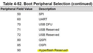

is hyperflash booting supported on TDA4VM Rev1.1?
I checked the errata related with hyperbus of TDA4 was resolved in TDA4VM Rev1.1 and also found uboot user guide for hyperflash as below.
https://software-dl.ti.com/jacinto7/esd/processor-sdk-linux-jacinto7/latest/exports/docs/linux/Foundational_Components/U-Boot/UG-HyperBus.html
But, I also found hyperflash is still 'reserved' for bootmode in TRM as below, and I'm wondering if TRM is not updated yet and hyperflash is supported on TDA4VM rev1.1 as a booting device.
Could you please clarify this and let me know if hyperflash booting can be supported on TDA4VM rev1.1 RTM device?

  • Hi SI,
    ROM support: Yes from ROM point of view HBMC boot is validated on SR1.1 for TDA4VM.
    Bootloader support:
    Hyperflash boot is supported in SPL/Uboot for DRA821 only today. This is not available on TDA4VM on rev1.1. So this is a SW limitation.
    I would suggest if Hyperflash boot is coming in as a requirement from your customer on TDA4VM then please create an internal JIRA requirement for the same so that we can discuss on plan to integrate that.
