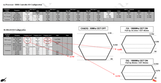

  • only few boards are ok, and the rate may be 20%.  We also looped SK Hynix in, and they suggest to change the Vref DQ and Vref CA
    does this make sense?
