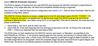

Dear Sir,
Customer target board use MMC1 to boot SD card without connecting SDCD pin (SDCD is floating).
SD clock cannot be measured during booting.
Is SDCD pin a must pin to be checked by ROM CODE during SD/MMC boot on AM64x?
BR, Rich
Dear Sir,
BR, Rich
