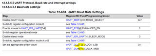

    Question 3
    About "12.1.5.6.7 UART_DLH Register" chapter of TRM.
      The CLOCK_MSB of the UART_DLH register is described as 8 bits.
      Divisor is 14-bit, so I think 6bit is correct.
      Is 8bit wrong?
    Yes, I agree that DLH description is incorrect. This is confirmed by table 12-653.
    Thank you for pointing this out. I will file a ticket to have this corrected in a future revision
    --Paul
