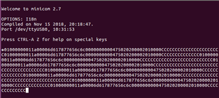

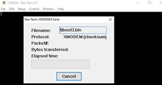

    I also tried the UART boot mode on PG2.0 EVM, SW3[4:1]=1010, send file from Tera Term in X-modem, there is no response on console connect to J42(USB).
    If set to UBOOT mode, should see something in console like that of AM335x "CCCC....."

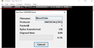

    Then I connect console to J30. power up the board, output a serial number on console then CCC, then send file with XMODE, only transferred 128 bytes

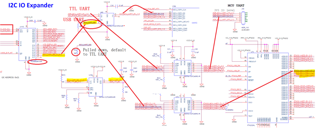

    Seems SPL configured I2C IO expander to select MCU_UART1 output to J30 or USB J42.

    Any Chance you can try with minicom? Also which SDK version? You should be connecting to MCU_UART you will see Ccc.

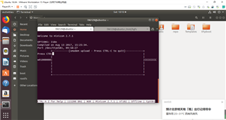

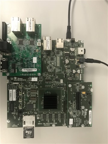

  • Keerthy,
    #1. Yes, I am verify it on EVM, UART connection as below:
    #2. Yes, there is CCC output on console, but not only CCC.
    #3. use xmodem to transfer tiboot3.bin, no success.
  • Tony,
    Thanks for sharing picture of EVM. We typically connect Micro USB port. Your board seems to be having a different
    connection for UART. Is this a custom board?
    https://software-dl.ti.com/processor-sdk-linux/esd/AM65X/latest/exports/docs/linux/How_to_Guides/Hardware_Setup_with_CCS/TMDX654_EVM_Hardware_Setup.html#supported-jtag-debug-probes-emulators
    You can see the port in the picture in the above link.
    - Keerthy
  • That was J30 on IDK which is the mcu_uart port,  to my understanding , you can also use alternative Micro USB port as well, that's the same port.

    I know the USB port UART. because there is not anything output from the USB port, then I connect to the TTL signal port. I explained on the first reply already: "Seems SPL configured I2C IO expander to select MCU_UART1 output to J30 or USB J42. "
    Please take a try on EVM. Thanks.
    I summarize the UART circuit of EVM as below, the MCU_UART output to TTL port in default as the MCU_UART_SEL pin pulled down to select channel A.

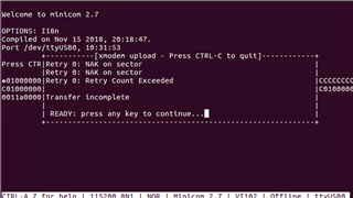

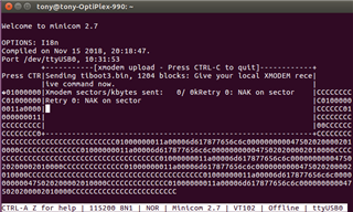

  • we also use minicom to transfer tiboot3.bin in xmodem,it also didn't work:
    how do you make it work?
