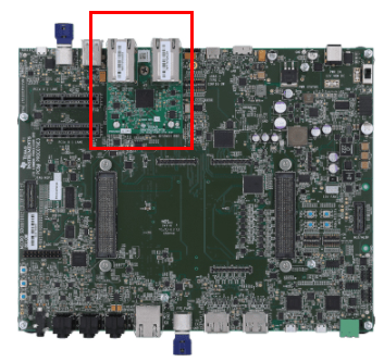

  • Hi Vineet
    We want to enable the following port in red quadrangle. Is that 5G?
    If yes, Custom board has only CPSW 5G, Not 2G.
    Is it technically possible to activate CPSW 5G in u-boot before Linux boot up.
    CPSW 5G need to be enabled to support tftp boot since custom board will not have SD and USB ports for production assembling.
    Thanks.
    Jack
  • Hi Jack,
    Yes, it's 5G (QSGMII ports)
    No, CPSW 5G cannot be enabled in Uboot. Theoretically it's possible but it's a lot of effort on SW port and we have no plans to enable it.
