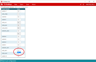

I use Pinmux tool for AM570x. I am using the offline version of v4.0.1543.
In the Power Domain setting of this tool, I can only select 1.2 or 1.5 for vdds_ddr1.
How should I set 1.35V?

UNA, That doesn't have any affect on the software configuration provided by the tool. You should choose 1.2 or 1.5V consistently to avoid getting a warning/error from the tool. Otherwise, you need to be sure on the PCB that you're PMIC is providing the right voltage (1.35).
This tool: AM57x, DRA7x, and TDA2x EMIF Tools (Rev. E) is used to configure the EMIF/DDR registers correctly for your memory type.
